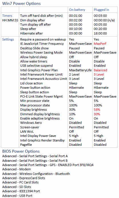

RDClaes, you could probably easily double your battery life by tuning your power options.
I usually get 9+ hours out of my cf19mk6, especially for indoor use.
- cf19mk6-power-options.png (44.09 KiB) Viewed 16667 times
Re: CF-20 Review! The Good, the Bad, and the Ugly!
Ooh! *off to edit the fuarrrk out of the standard Panasonic Power Saving config*Karl Klammer wrote:RDClaes, you could probably easily double your battery life by tuning your power options.
