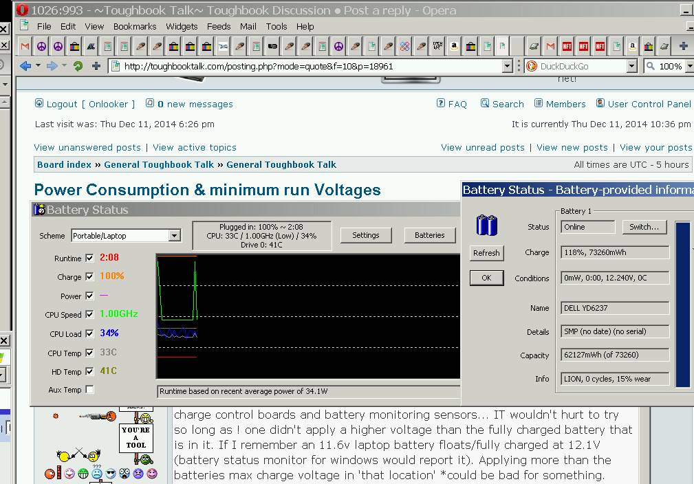

In the old days that could possibly work, but I highly doubt it with the lithium charge control boards and battery monitoring sensors... IT wouldn't hurt to try so long as ! one didn't apply a higher voltage than the fully charged battery that is in it. If I remember an 11.6v laptop battery floats/fully charged at 12.1V(battery status monitor for windows would report it). Applying more than the batteries max charge voltage in 'that location' *could be bad for something.
fun fun
Battery status in front of Opera v10.10 browser with my avg # of tabs open; Chrome, firefox just can't come close :( resource wise..
