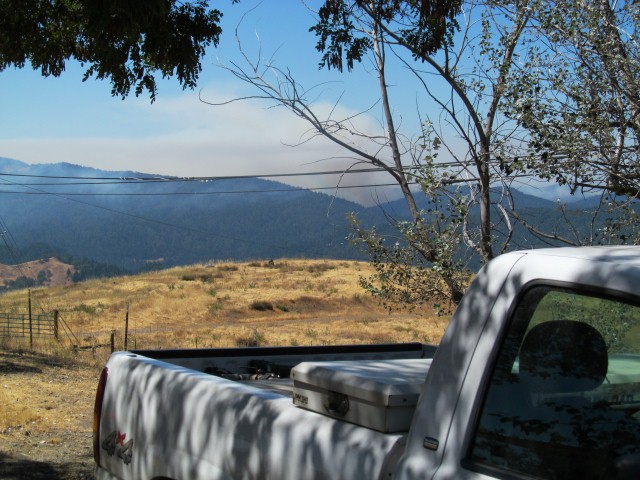

This is the smudge just after a wind change taken from the sidewalk lol path in front of my house. Fire backing down to 101 and Leggett, CA.
- smoketruck (Small).jpg (119.56 KiB) Viewed 13992 times

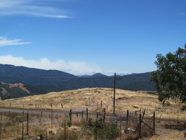

Are those power lines? I thought you were off the grid Jeff?
Re: OT Lightning and fires.
Telephone and fiber optic. Wind change....... getting poopie. New pic in a second.
- IMG_0030.JPG (83.54 KiB) Viewed 13974 times
