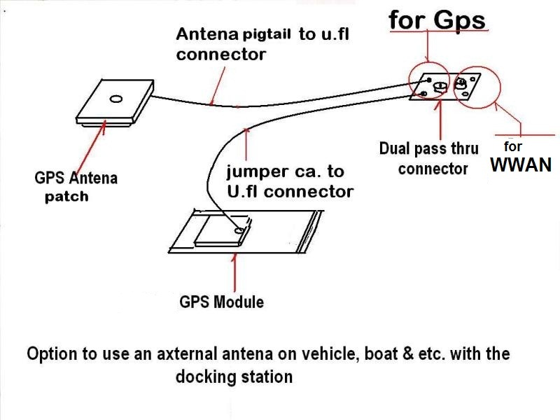

subcaptian wrote:Would it be possible to reconfigure it to use WWAN and GPS?
Yes! It can be done pretty easy. Sorry! Rob you maybe confused. sub..t'n, here is what you gonna do but it require to open up the buttom cover of the unit(see manual). Assuming that the unit are ready, bottom out. ldentify the wi-fi passthru connector and then pull out the two plug on connector on it. Then directly plug in the wi-fi cable to the wi-fi card. Now! you have an spare jumper, measure that jumper If it can plug it in all the way to GPS module If not you need an spare coax. that is long enough from passthru con.. all the way to the GPS module. here is the block diagram for your reference. Enjoy!!
PS. I have done this so many times as per customer requirements from CF-28, CF-29, CF-30, CF-18 and CF-19 toughbook.
gps for dock.JPG (87.94 KiB) Viewed 10315 times
