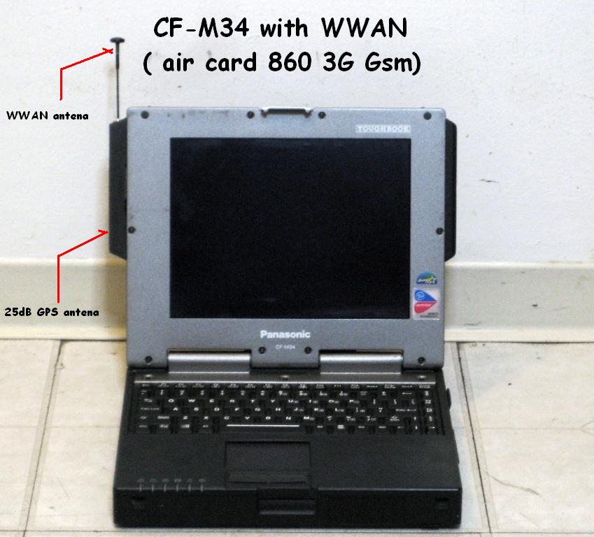

I also had an idea on integrating a WWAN on this unit using the PCMCIA short card but with builtin antena. The antena is from CF-29 including its base pcb board that installed inside the LID with just an inch jumper in order to minimize lost signal. I started on an antena installation couple with GPS antena.
Here you go.
Here you go.
