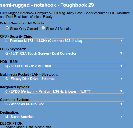

LQQ says dual connector touch?????????????????????????????????????????????????????????????dual????New one on me.
Click silver arrow up there /|\ look for old configurator.
Re: CF-29 Serial Port Not Recognized
#16 Post by SHEEPMAN! »
This one.
