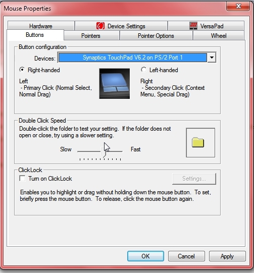

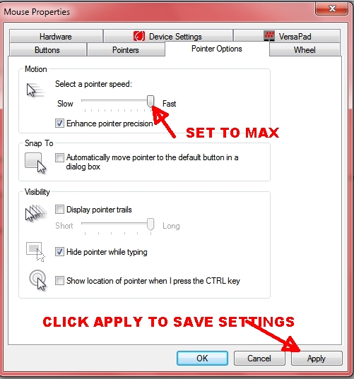

Try adjusting the sensitivity and speed in the touchpad application in the taskbar on the bottom right.

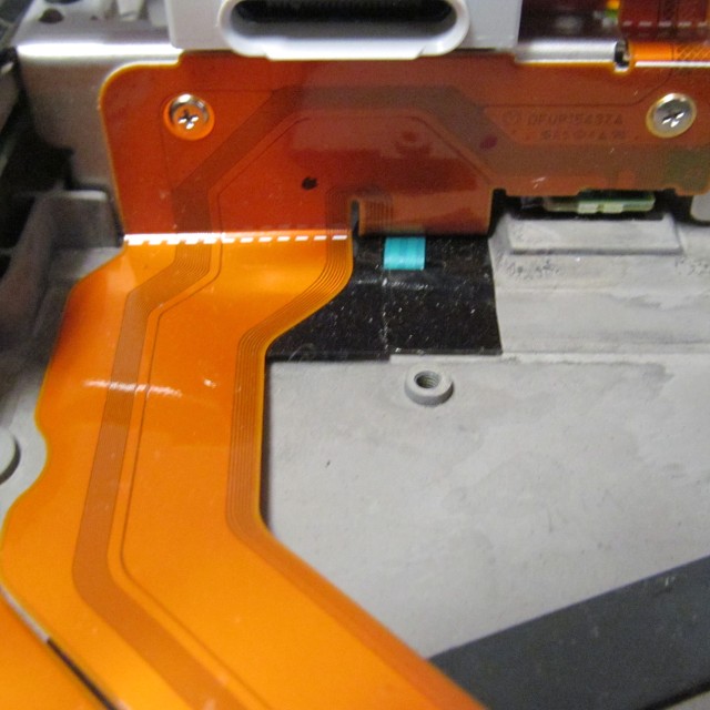

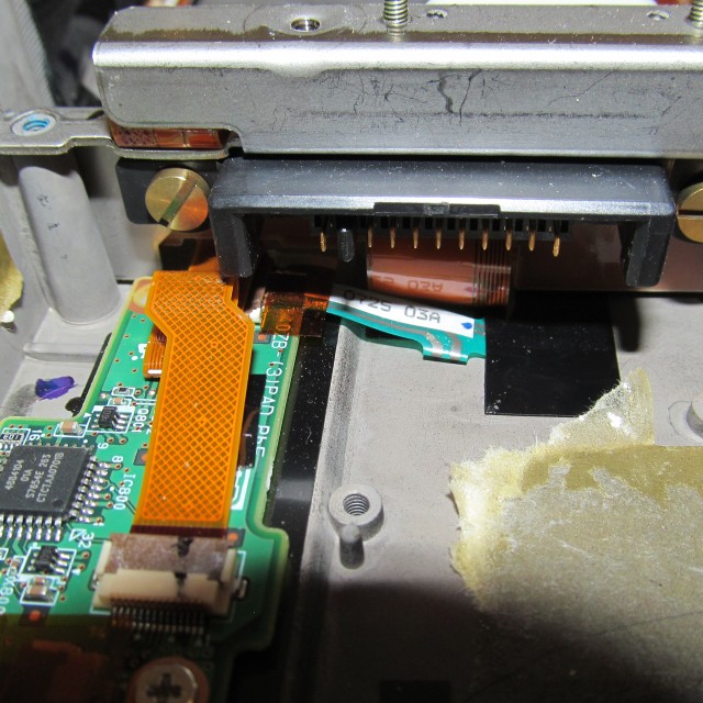

Here's where you have to go.
The silver bar supports and connects the battery and hard drive.
That green cable comes through a slot in the case. Yours will be covered by a square of black tape on the battery side. It's a lot smaller than it looks. The connection is partially under the battery connector.

Before you attempt to mess with the touchpad hardware, try a software solution. Try a driver direct from Synaptics.
http://www.synaptics.com/resources
Then open the mouse//touchpad control from the taskbar or click MOUSE in windows control panel.
