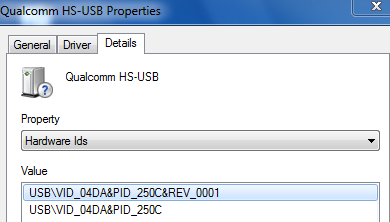

After you do a power pull reset and set bios to defaults check device manager for the Gobi entries. If none there it may be a dip switch.
If they are there right click one and check properties. The second entry in details (hardware i.d.s)should have an entry for 250D. Send us a picture and do a google search for the complete id. If it's 250C it's a Gobi 1000.

ok ... i figured out what was going on .
when all else fails ; R-RTFM .
it is working ok now .
i installed the "locked down" single carrier version (verizon) .
it turns out that the unit is a 250D/1000 .

I was thinking about sheep or something but are you sure the 250D is Gobi 1000? I had it in my puny head 250C was 1000, 250D was 2000 and I'm seeing 250E now. (3000?)
250D will act as GPS. Check the com ports for the NMEA entry. Yes, Gobi 1000 has it too but it's mostly non-functioning. (I say mostly because I know a guy that used GPS function in the 1000)

Double post for picture of 1000.
- gobi.PNG (23.57 KiB) Viewed 18314 times
Re: gobi 2000 installation ...
in the verizon access manager the device shows as a "GOBI 1000" .
