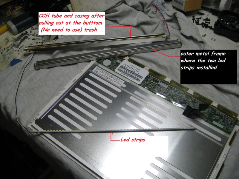

Second: assuming that you already pull out the lcd panel from the bezel. Now! unscrew the two screw at both side where the metal guide located, then followed by four screw total on the metal frame. They are all hidden as they are all cover by plastic with rubber bumper. then carefully detach the metal frame on the lcd.
Third: unscrew two screw where the buttom metal support on the CCFl tube and then pull it out backward. Then followed by taking out the ccfl metal case. always be patient on doing it. This ccfl metal case with the tube is no longer needed(garbage)
Fourth; Now! Install the two LED strips into the metal support case facing upward. These strips has already an adhesive, If not, you can use 3M led strips double sided tape.
Fifth; Before assembling the lcd with new led backlight, make sure to add addition deflector at the back( prefer black or metal plate also) line up to the front plastic frame. This is a must so that not to create a shadow when the LCD is on at the button part.
See a few photo below for your reference.
Replacing the ccfl tube into an LED backlight( CF-30 LCD)

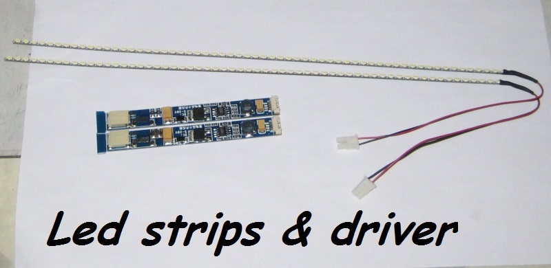

Ken! here where I've got the led strips and drivers.
http://www.ebay.com/itm/221295792207?ss ... 1439.l2649
I can't find a single driver with two slot for Led strips. What mostly available with two slot has a 12Vdc input while on Toughbook you only have 5Vdc supply. You can still use those 12Vdc but you need an step up regulator. The one I used has input voltage of 5-20Vdc which is perfect for this project.
What I did is using two driver for each led strips and then connected parallel into an inverter supply line of the Toughbook.

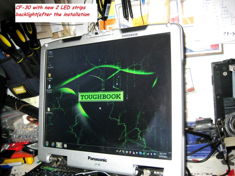

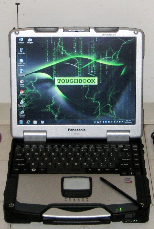

After burning of at least 6 hrs. with battery or AC alone(CF-30). It is stable and the battery last for another 15 to 20% more. Here is the final unit after assembling to final stage with all the bells and w... BTW, Its on Ebay now! Lol....
