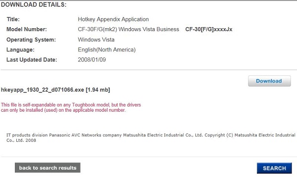

If I am right this is the one I downloaded for mine http://pc-dl.panasonic.co.jp/dl/downloa ... 071066.exe
- hotkey app.JPG (49.65 KiB) Viewed 19048 times

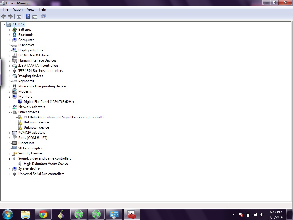

Re: INTERNAL SPEAKER not working on CF-30 with Win 7 Pro 32-
Unknown devices:
Guessing properties are ....MAT0019 hotkey and ......MAT0021 miscellaneous (called newmisc) at the exclamation marks. I do the second one first.
Double click the item or right click and navigate to properties in the device manager to confirm.
https://www.google.com/search?btnG=1&pw ... Fpanasonic
replace TEST with your query.

I downloaded and installed the HOT KEY APPENDIX as well as the MISC driver, and the SOUND WORKS NOW!!!
However, doing this killed my dimming on my screen. SOO... I uninstalled the Intel graphics driver, and installed the version that was the same as the Hot Key and MISC driver era (Vista for CF-30 MK2). I then got a blue screen of death... but, upon restart, everything is now working fine! Including the icons popping up properly for all functions..
Going to try the 2nd PC now and will advise what happens!
Thanks for the help!
