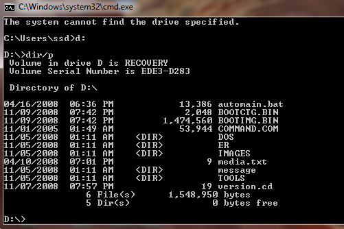

Interesting...W7 does not show command.com but it has to be there....so [menu][cmd] and this becomes visible. Example of Panasonic Factory restore MK3 XPP for a CF-30.
- command1.PNG (53.18 KiB) Viewed 16725 times

Its there but it must be messed up,hmmm,now what to do? Make an iso of the disc and unpack it with winrar,then grab the command.com file from another and replace it?
