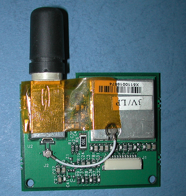

I am guessing you are talking about the Gobook 3's on ebay for 40 bucks plus shipping. I picked up too. I just got home from work last night and looking through them today. The GPS should be located in the bump that is on the top of the display. It seems the standard models have flat lid. I got one gobook 2 and it turns out to be a bellsouth model. Looking at stripping the board and putting the 3g card in the Gobook 3. I plan on doing some work on it tonight, maybe swapping out the cpu to the 2.0 I have put up. Let you know how it goes, maybe add a few pictures.

Let us know if yours shows up in the bios or if you find out where it's located. On the bottom of it there is a cover with the windows sticker on it, I have nothing in it but it looks like something was installed there but was removed so that got me wondering if the GPS was taken out.

Mine both have nothing there, BUT on my gobook 2 there is a daughter card that has a pcmcia slot and 3g cingular card in there. The gobook 2 was a Bellsouth model. It has bellsouth logo on the ft and it has bellsouth at the bottom of the factory sticker on the back.
Reading up on the gobook 3 today it said something about the gps not showing up in bios, but will show up in device manager. The gobook 2 uses a different gps unit than the gobook 3. The gobook 2 has pcmcia slot on the side where the gps goes, you replace the door with the special gps bump door and slide the card in. Look at the lid of the regular gobook 3 http://www.ebay.com/itm/ITRONIX-GOBOOK-3-IX260-MCent-1-8GHz-768MB-1906-/170707426308?pt=Laptops_Nov05&hash=item27bef49c04 and compare it to the one that have gps http://www.ebay.com/itm/Itronix-GoBook-III-IX260-Rugged-Wireless-Laptop-1-8GHz-512MB-NO-HDD-CADDY-/220868067506?pt=Laptops_Nov05&hash=item336cc340b2 I found pictures of the lid taken apart to run a new wifi antenna and the bump on the lid was still there, and them saying it had a funny looking antenna on the gps on the gobook 3 under that bump. http://groups.yahoo.com/group/ItronixGoBook/photos/album/2056522420/pic/1232527403/view The yahoo groups have been the best info I have found so far on the gobooks.
On ebay they have a few of the pcmcia cards that are under the slot that has windows sticker. http://www.ebay.com/itm/Itronix-GoBook-IX260-MT-4516C080-PCCARD-PCMCIA-Bay-Cage-/180587179928?pt=LH_DefaultDomain_0&hash=item2a0bd5af98
http://groups.yahoo.com/group/ItronixGoBook/photos/album/0/list
Wanting to say also I read look for com port 4 and set it too 4800 baud
http://www.gd-itronix.com/index.cfm?page=Drivers:Selection_List&product_choice=IX260%2B&os_choice=Windows%20XP&is_old=0 DRIVERS
bluetooth and gps under the bump on the lid http://groups.yahoo.com/group/ItronixGoBook/photos/album/1454536623/pic/898829437/view
Daughter board of gobook 2 and 3
Gobook 2 gps module
Gobook3 gps and bluetooth module bump on lid (not on gobook 2)

GOT IT!!!!!!!!!!!!!!!! GPS AND BLUETOOTH
We got ours from the same seller so here is what I did. I used a cd version of xp that i had nlighted to slim it down and use on CF-28's. It took with out a problem, went to the download page I posted earlier and installed all drivers. Went to the Intel site and installed Intel 2200 wireless card driver. Got the GPS to work on com 4 at 4800 baud using visualgpsxp on the first try, but sitting in the house and having it on for just a few minutes it didn't get a fix. Still need to test out Ubuntu and try calibrate battery to see if it will work for me. I knew I couldn't sleep with out messing with it a little more, lol. Well off to bed, more to come for tomorrow, lol.
